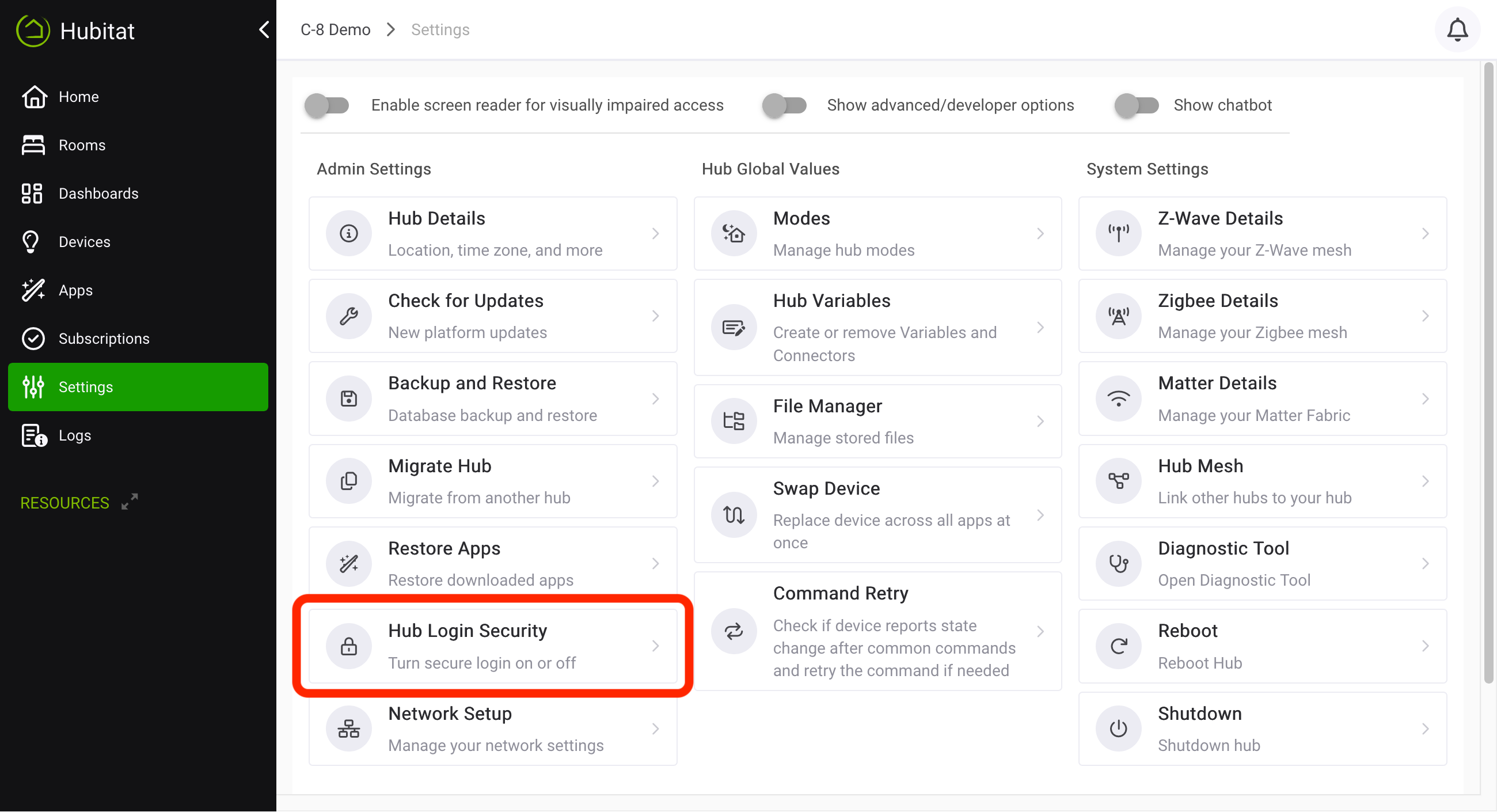

To get started, go to Settings and select Hub Login Security.

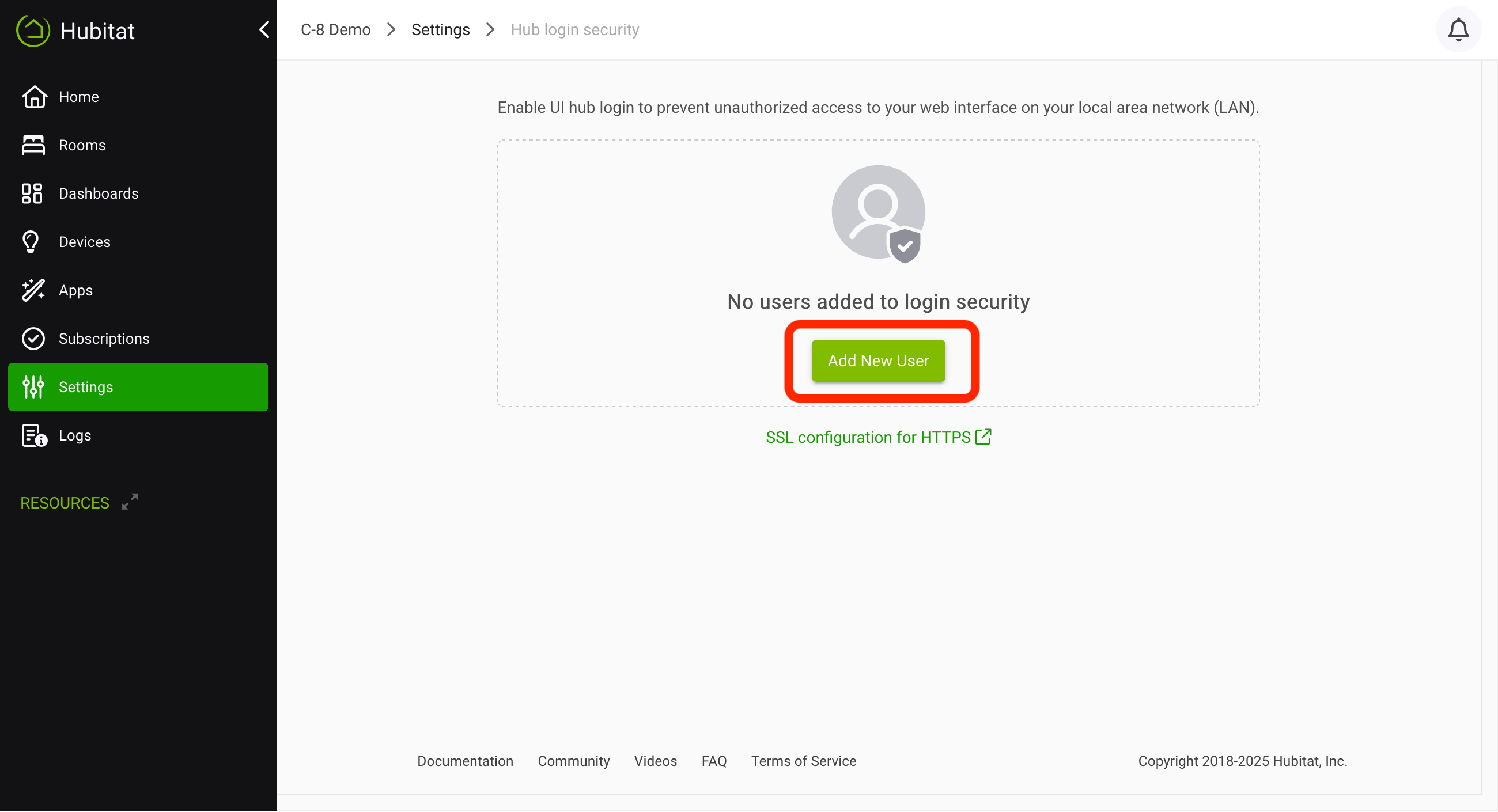

Select Add New User:

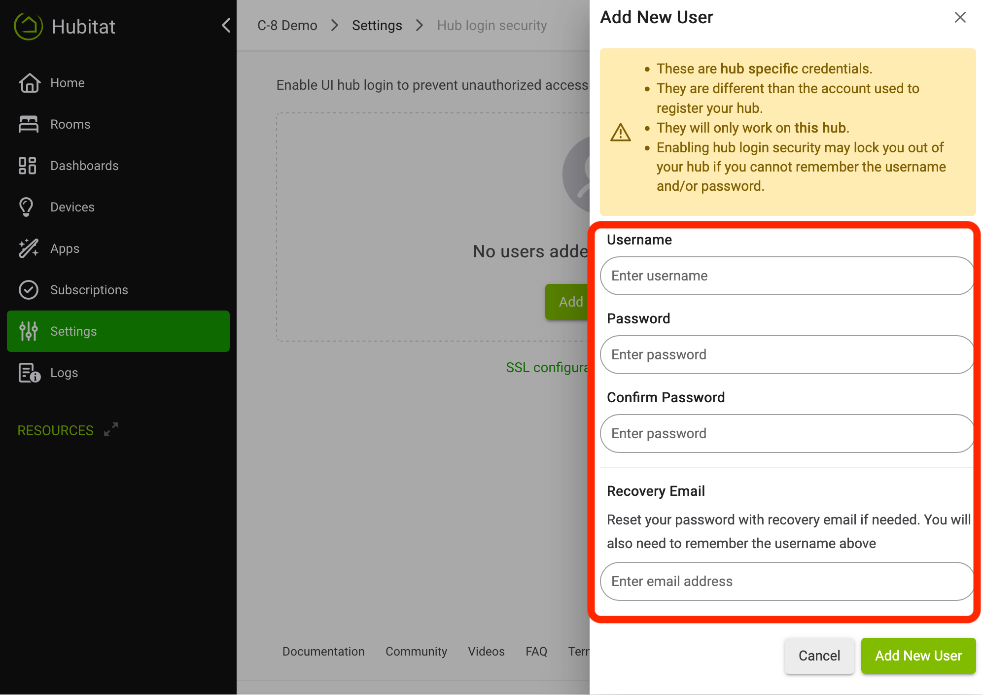

Follow the prompts. Note that the username and password are both case-sensitive:

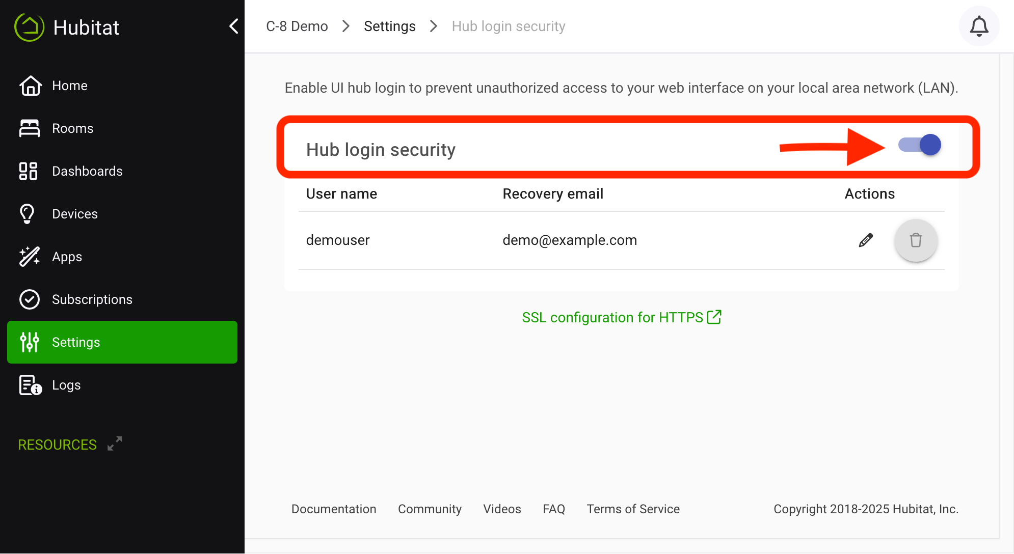

To actually enable hub login security and restrict login with a username and password, activate the Hub Login Security toggle at towards the top of the page:.
You will be immediately required to login with the username and password you created:

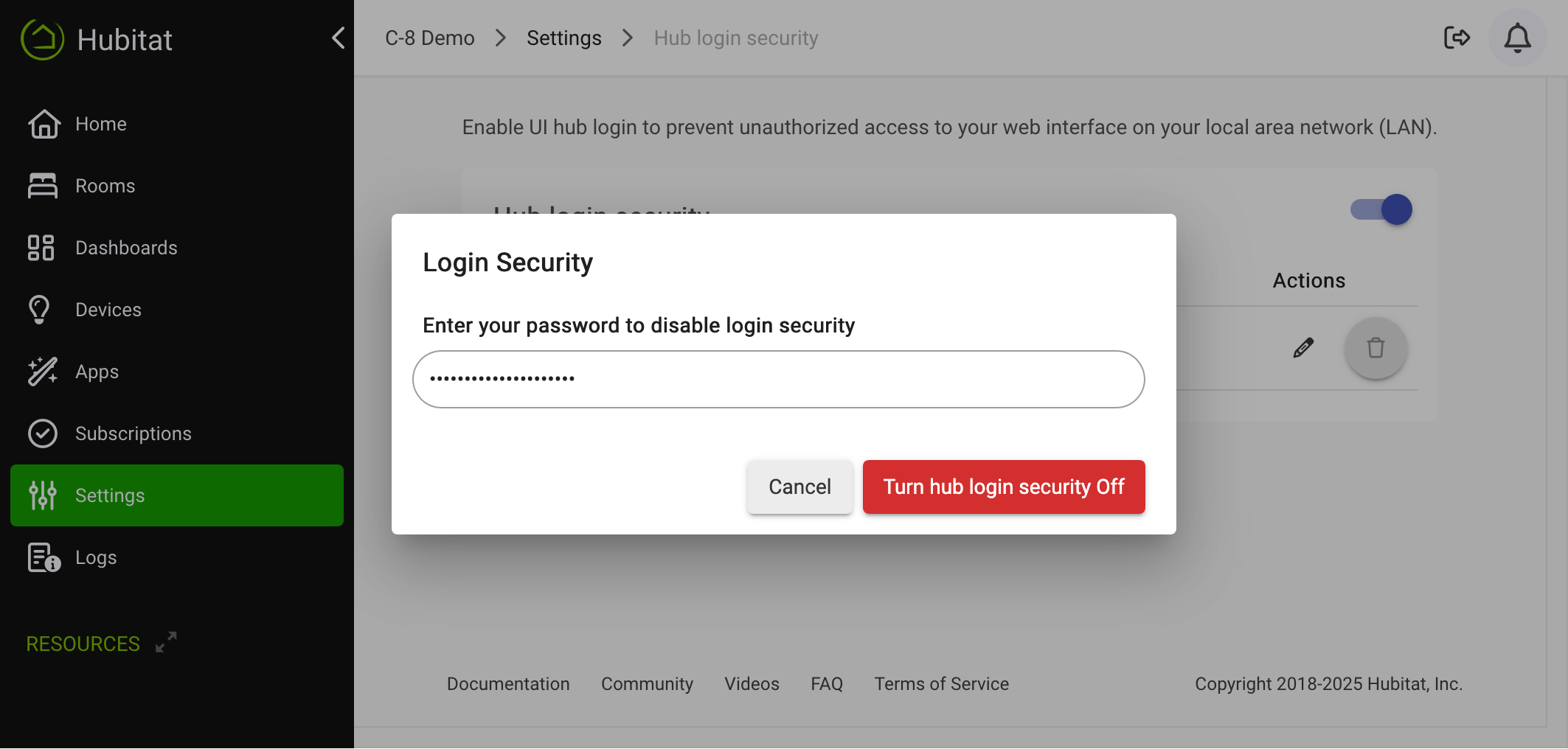

To disable Hub Login Security, turn off the "Hub Login Security" toggle. You will be prompted to enter your password to confirm:

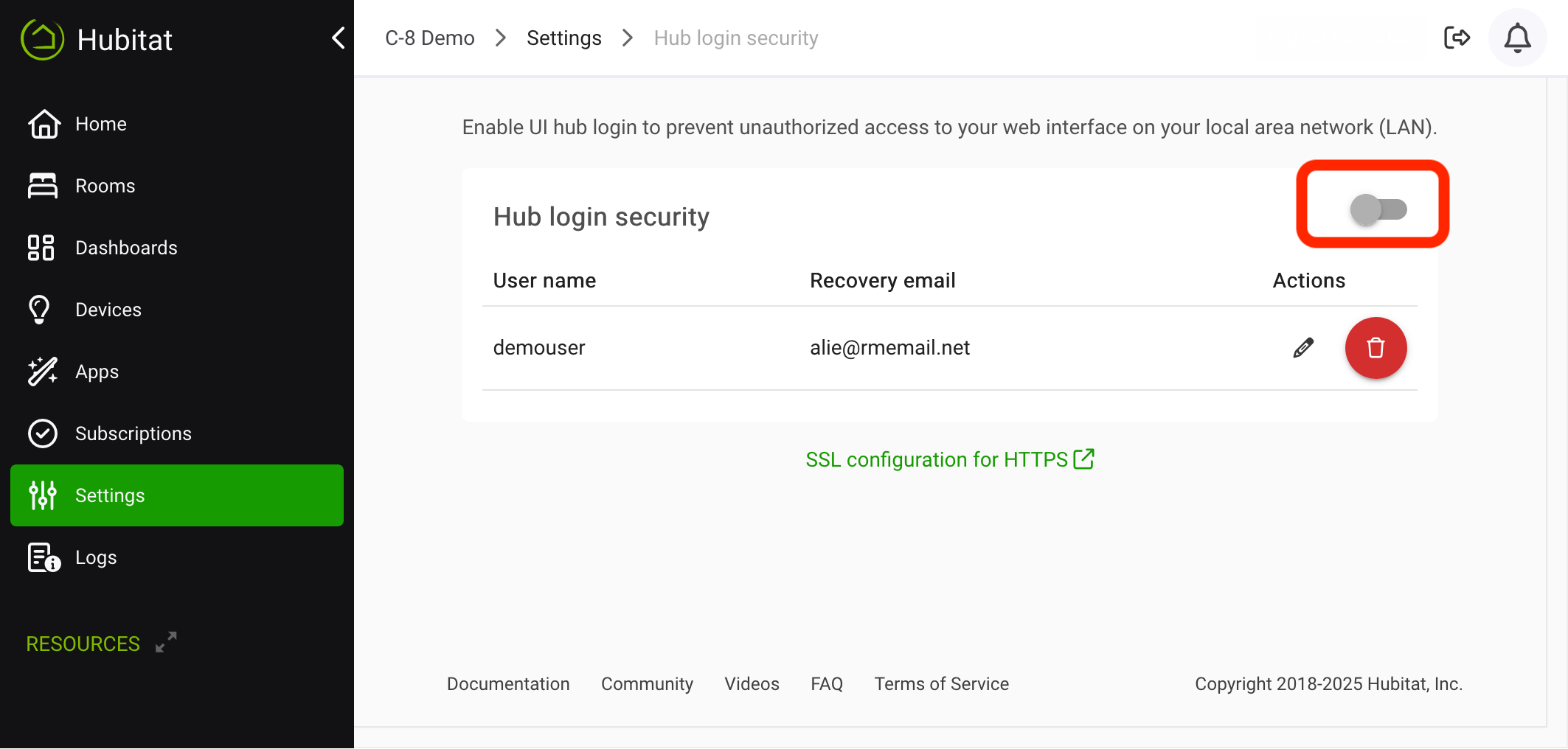

When hub login security is not enabled, the toggle will appear in the "off" state:
