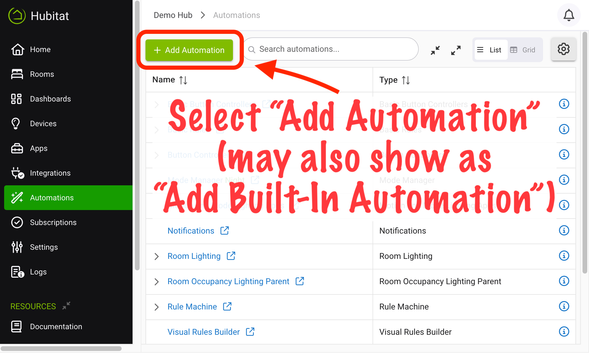

From the sidebar of your hub, navigate to Automations and select Add Automation or Add Built-In Automation:
