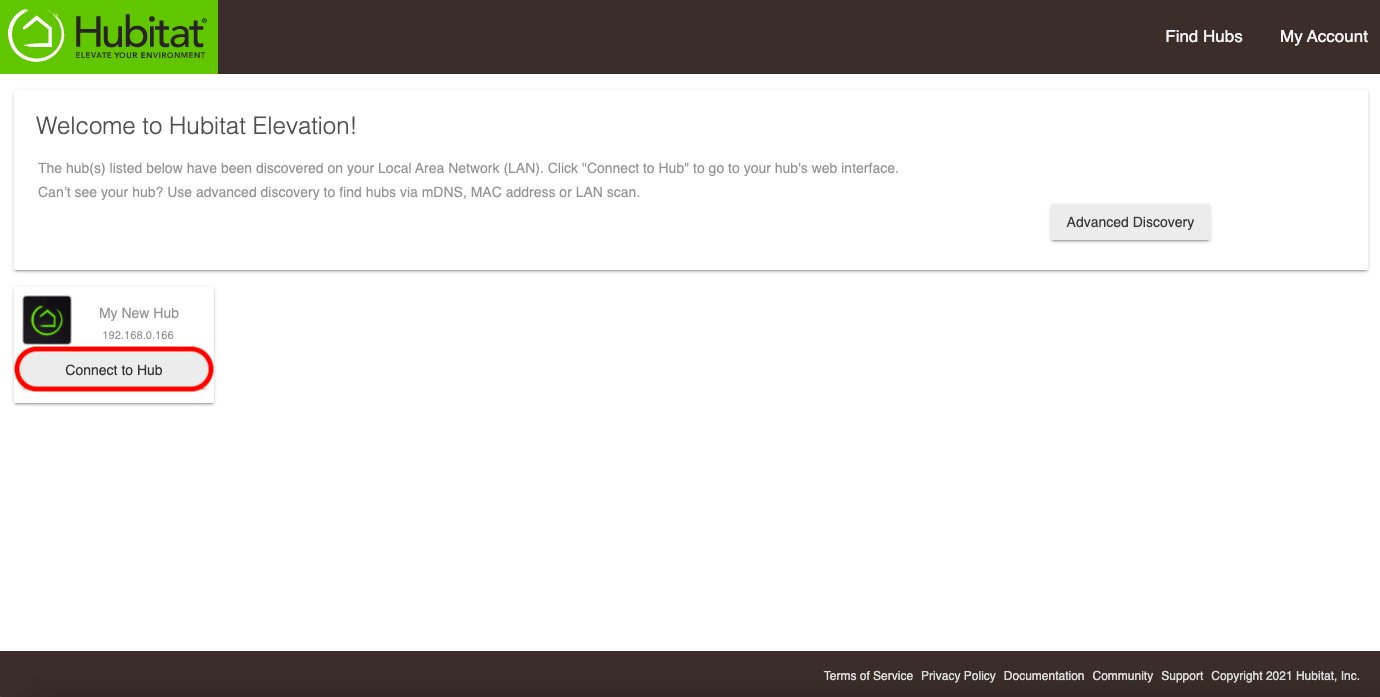

IMPORTANT! Your computer or mobile device must be on the same Local Area Network as your hub in order to register. If your hub does not appear, ensure you have your hub and computer or mobile device connected to the same router and network. Also make certain and they are not isolated by a WiFi guest account. If your hub still does not appear, press the Advanced Discovery button to find hubs via mDNS, MAC address, or LAN scan.
Press the Connect to Hub button.

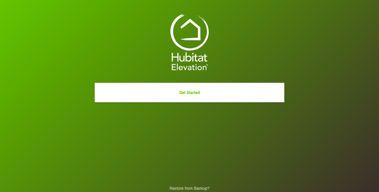

Press the Get Started button.
NOTE: If your "Get Started" page does not look like the above (it will have a white background with a green button instead), you probably have newer hub firmware and should follow the current Registration and Setup document instead.
