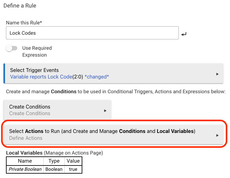

Create a new Rule Machine rule (navigate to Apps > Rule Machine, or install it first if needed, and select Create New Rule).
Name the rule Lock Codes.

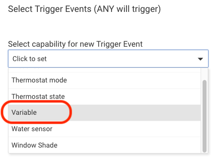

Navigate into Select Trigger Events. Under Select capability for new Trigger Event, choose Variable.
Set the Variable to the Lock Code variable you created in step 2, and set the Comparison to *changed*.
Select Done with this Trigger Event, and then select Done with Trigger Events.
Navigate into the Select Actions to Run page.

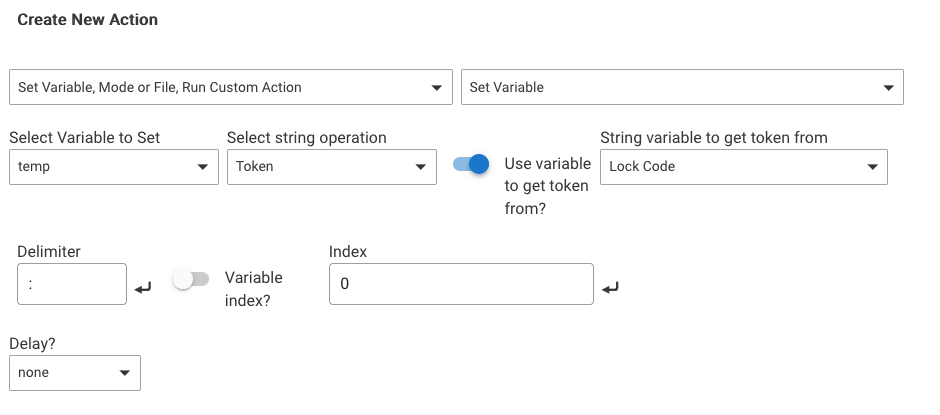

Select Create New Action (under the table towards the top of the page) to add your first action to this rule. Select Set Variable, Mode or File, Run Custom Action for "Select Action Type to add," and then Set Variable for "Select Which Action."
Choose temp for the Variable to Set, and Token for the string operation.
Enable Use variable to get token from? option, then select the Lock Code from the list (under "HUB VARIABLES").
Enter : (colon) in the Delimiter field, and 0 in the Index field, then select Done with this action.

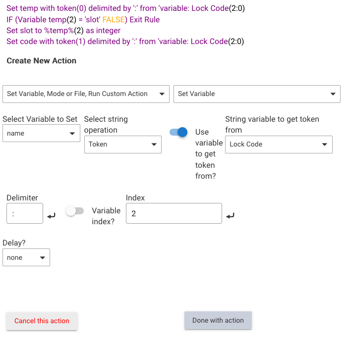

Select name for the Variable to Set, and choose Token for the string operation. Enable the Use variable to get token from? option and choose the hub variable Lock Code as the "String variable to get token from."
Type a : (colon) in the Delimiter field, and 2 in the Index field, then select Done with action.
